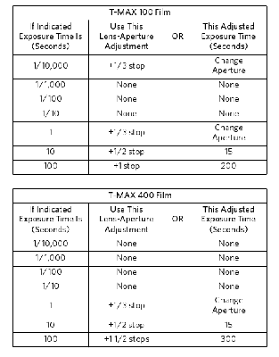

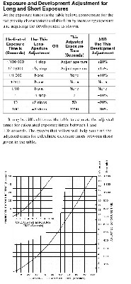

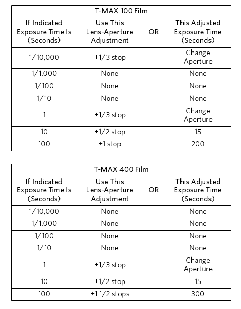

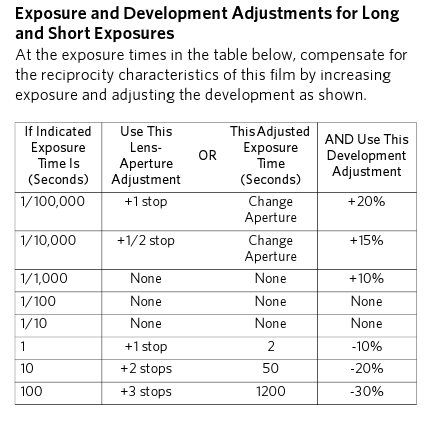

Poniżej czasy dla materiałów KODAK:
Link do zdjęcia: Efekt Schwarzschilda KODAK TMAX
Link do zdjęcia: Efekt Schwarzschilda KODAK emulsje klasyczne

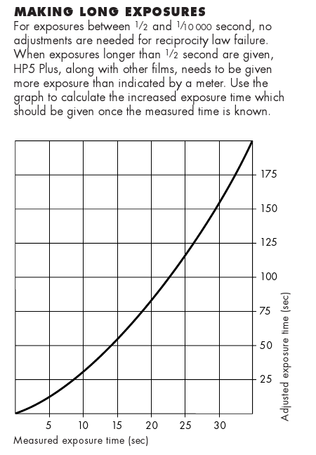

HP5+

Kodaki serii Portra:
"Adjustments for Long and Short Exposures
No filter correction or exposure compensation is required for
PORTRA 160NC, 160VC, 400NC, 400VC, or 800 Films for
exposures from 1⁄10,000 second to 1 second. For critical
applications with longer exposure times, make tests under
your conditions.
zaczerpnięte z pdf-u producenta :roll:

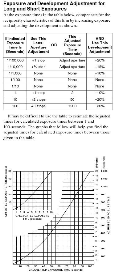

Kodak Plus X
